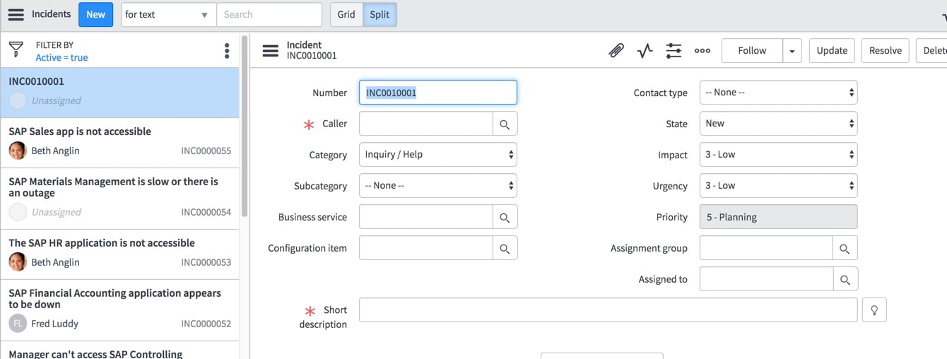

Please give me navigation (with screenprints) how to navigate to Split Mode

Sorry for the confusion. The plugin name is "List v3". You activate it by going to System Definition> Plugins
The screenshot I showed is a simple incident list and I clicked the Split button at the top. Grid brings it back to the normal layout.

Hi Suresh,
In UI16, you need to activate the List v3 plugin. Logout, login, and anywhere you see a List v3 layout, you can click on "Split" mode.

We r testing List V3 in Helinki Release.
What is UI 16. We r testing on Windows machine in IE.
So, this v3 is available in Helsinki. I have to activate the V3 plugin. Ok.
And, the image u have given is V3 --------- or does it have 2 versions side-by-side.
