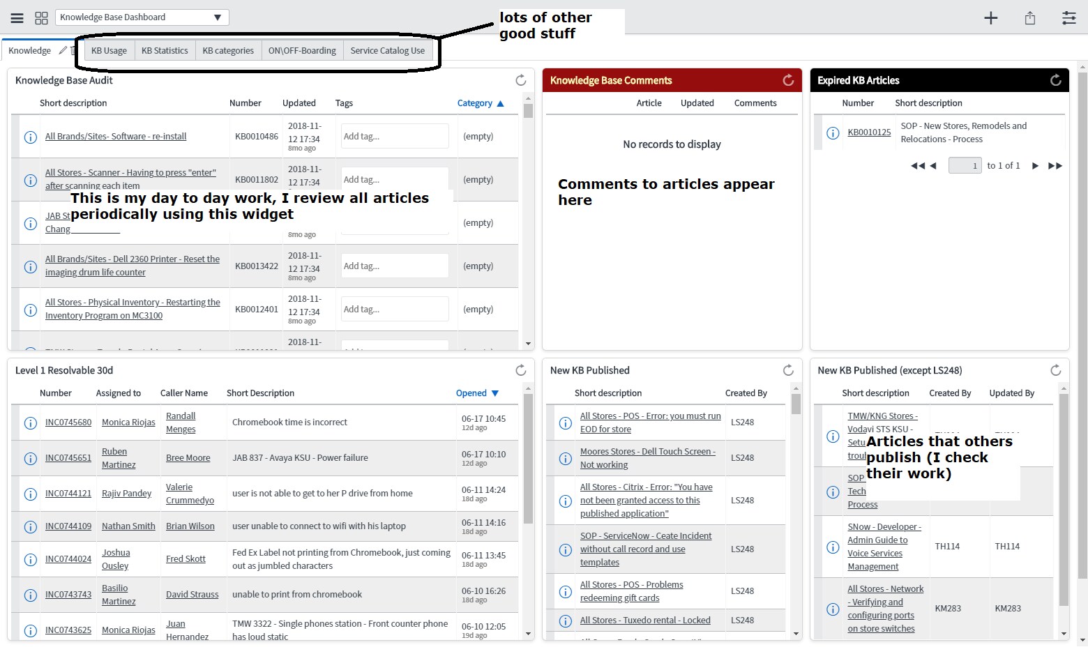

I monitor everything in our knowledge bases from a dashboard:

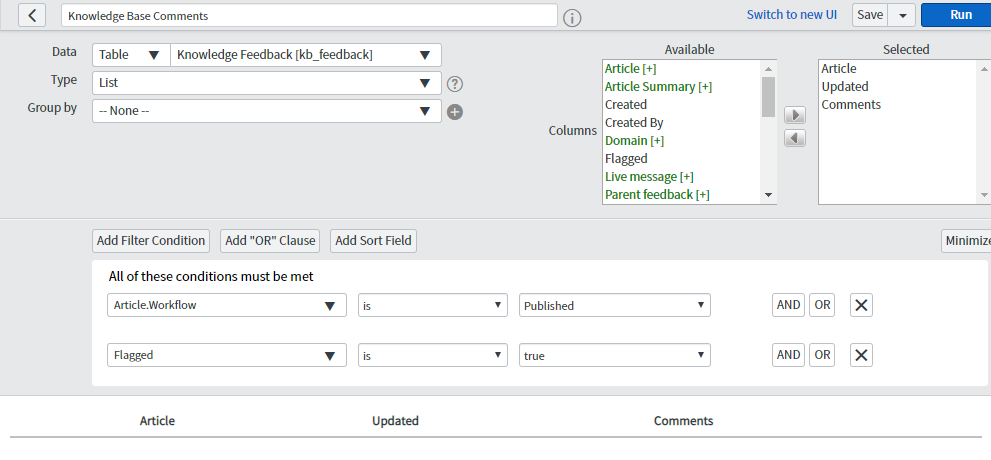

Here is how I built the comments widget:
When someone leaves a comment I address it as soon as possible then I remove the flag
A dashboard like this can be used by multiple KB managers at the same time.
Hope it helps
Lorenzo
‎07-02-2019 08:49 AM
Hello Lorenzo,
Can you send the query on the rest of the widgets Our KM's have been asking for something like this.
Chad
