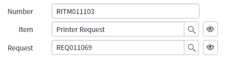

I have seen some partial solutions but haven't really come up with a good working solution as of yet. My use case is as follows:
Setup) I have glide.ui.clickthrough.popup set to true because for 99% of our users this behavior is more useful and preferred.
However, since the popup does not load related links (due to the sysparm_referring_url = tearoff), this is not working well for people with Request Item tickets. The users fulfilling request items like to be able to click on the reference icon next to the "Request" field on the form and be able to use the related links at the bottom to finish their requests.
(Example of the reference Icons I am referring to)
So, is there:
1) A way to have glide.ui.clickthrough.popup = false for Request only and not for the rest of our instance?
2) If not, how would I override the URL when it opens in a new window to remove the "sysparm_referring_url" portion? I have seen this Reference Icon click open in new window which states that a UI Action should be able to do it, but I am unsure of how to trigger that UI action when clicking on the reference icon? Excuse me, I am very new to ServiceNow. Thanks in advance for any assistance!
