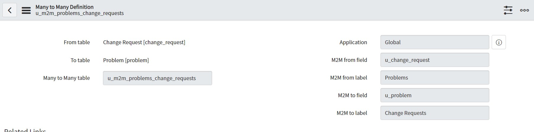

I am using new related list to relate change to problem and problem to change with M2M relationship.
I have created M2M record :-
Change form problem related list:-
https://dev107487.service-now.com/u_m2m_problems_change_requests_list.do?sysparm_query=u_change_request%3De207c4f5872599945c7664290cbb3583%5E&sysparm_view=
now i am getting u_change_request
Problem form change related list :-
https://dev107487.service-now.com/u_m2m_problems_change_requests_list.do?sysparm_query=u_problem%3D2ce15921872955945c7664290cbb35c2%5E&sysparm_view=
now i am getting u_problem
Note :-
Now the issue is when i am try to create Standard change form problem ( hamburger menu ) i am not able to relate problem on change request problem related list.
I did some changes on OOB Create Standard change UI Action but it's not working.
can any one help me on this, how I can fix this issue.
