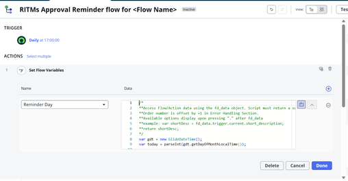

You can create a Scheduled Flow that runs daily at 12 AM, and then control the logic so it proceeds only on the 10th, 11th, 12th, and 13th of the month.
Here's how I tested it in my instance:
  • I created a flow variable of type True/False called Reminder Day.
  • In the very first step, I used "Set Flow Variable" and added a script to check if the current day is one of the 10th, 11th, 12th, or 13th. If yes, it returns true, else false.
  • var gdt = new GlideDateTime();
    var today = parseInt(gdt.getDayOfMonthLocalTime());
    if (today === 10 || today === 11 || today === 12 || today === 13) {
        return true;
    return false;

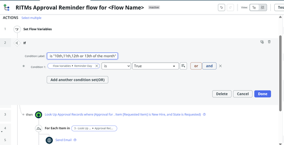

  • Then I added an If condition to check if Reminder Dayis true. If it’s false, the flow stops there.

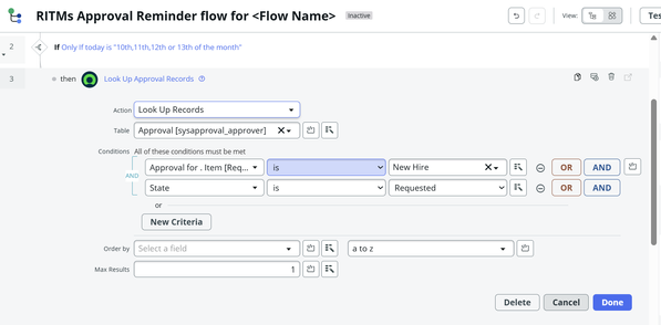

  • If true, the flow continues — I used a Lookup Records action on the sysapproval_approver table.
    • Condition 1: state is requested
    • Condition 2: dot-walked to Approval for-> request_item -> cat_item and selected the specific catalog item name I wanted to target (you can adjust this as needed).

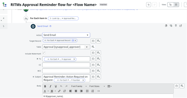

  • After that, I used a For Each loop on those lookup records we did and directly added a Send Email action inside it — since all necessary checks were already done before this point.
        return true;
    return false;
