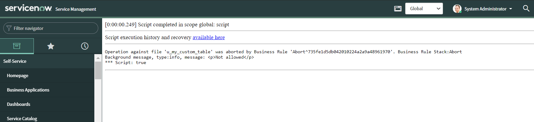

I am having issues with gr.isActionAborted(). Even though my update does NOT go through, gr.isActionAborted() returns false. Weirdly, when logging gr.update(), it returns null... I logged it like this. This code snippet is placed within an if-statement checking that grTask.isValidRecord()
grTask.update();
gs.info("grTask: " + grTask.update());
gs.info("is action aborted?" + grTask.isActionAborted());
see image below
1) I have 1 Before BR which blocks the update
So isActionAborted() -> gave true
I deactivated the BR and
So isActionAborted() -> gave false

isActionAborted returns false which means your grTask update is working fine.
If it returns true, then it means that your operation is aborted.
Did you check record got successfully updated or not?
if it gets updated properly it means that function would return false
if record not gets updated then that function would return true
Did you check any before update BR is restricting the update operation?
