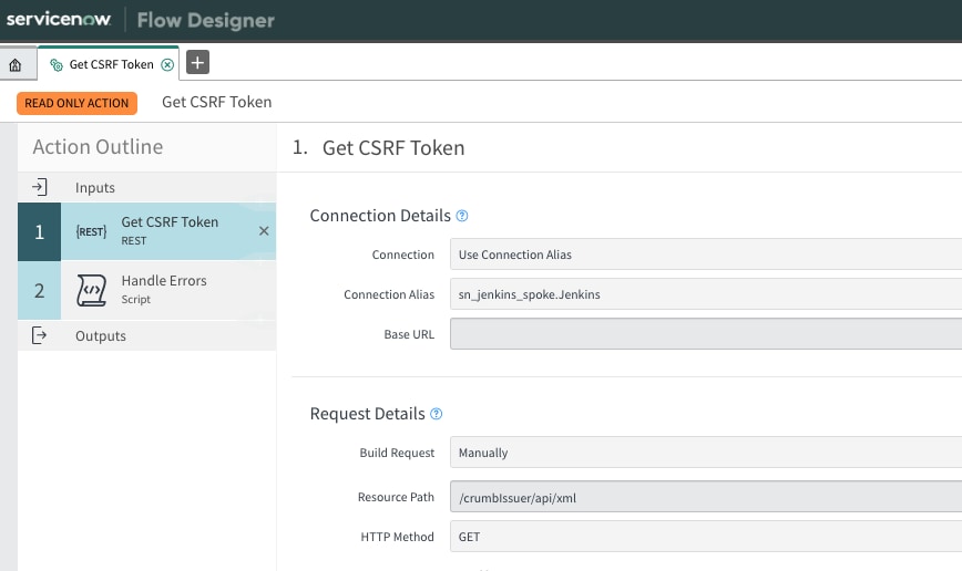

The bare minimum actions you would use to test performing a build would be the following:
1. Get CSRF Token Action
2. Perform a Build Action
What I would do is make copies of those actions and then configure the required parameters like Connection Alias for the "Get CSRF Token Action" and Job Path for the "Perform a Build" Action.
**be sure to publish those newly created actions or you won't be able to use them in any Flows. Also make sure you have already created your Jenkins Connection and Credential Alias as stated in the ServiceNow Documentation I gave the link for above.
 Once you have published the actions, go into Flow Designer and make a simple Flow that uses them.
**hint, I usually use Run Once as my trigger when first making Flows and testing them out.
 ! notice that I used the "CSRF Token" Data Pill that was the output of the "Jenkins Test - Get CSRF Token" Action in the CSFR Token Parameter Field of the "Jenkins Test - Perform a Build" Action. Just pull it over and drop it in.

Hi Ezra,
I tried executing action Get CSRF Token which return value. But when the Build still fails with the error as No valid CSRF token was included in the request.
I did include in the script section of Perform a Build Action, along with including it in the inputs & input variables , csrf_token.
Script::
inputs = new JenkinsUtils().trimStringInputs(inputs);
outputs.csrf_token = inputs.csrf_token;
Is there any other place where i need to include the csrf_token other than the script section of Perform a Build Action ?
