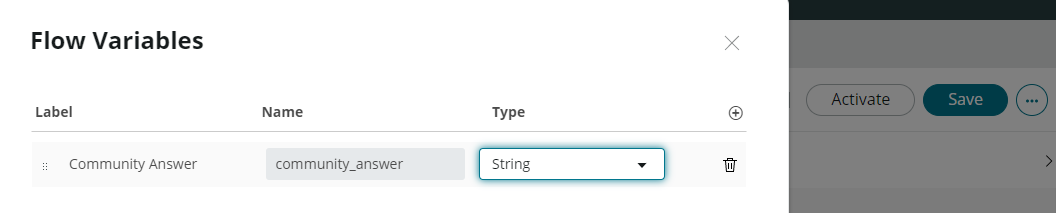

I believe that you are using Get Catalog Variables Action to have your variables as Data Pills. If this is the case then follow below steps;
  1. Create a Flow Variable of type string
  2. Use Set Flow Variables to set the DisplayValue of sys_ids you have.
  3. Use that flow variable in the body of your email.

Hi @Muhammad Khan ,
Thanks for your response but I am not getting any variable to select.
It will be under Flow Variables  at the top

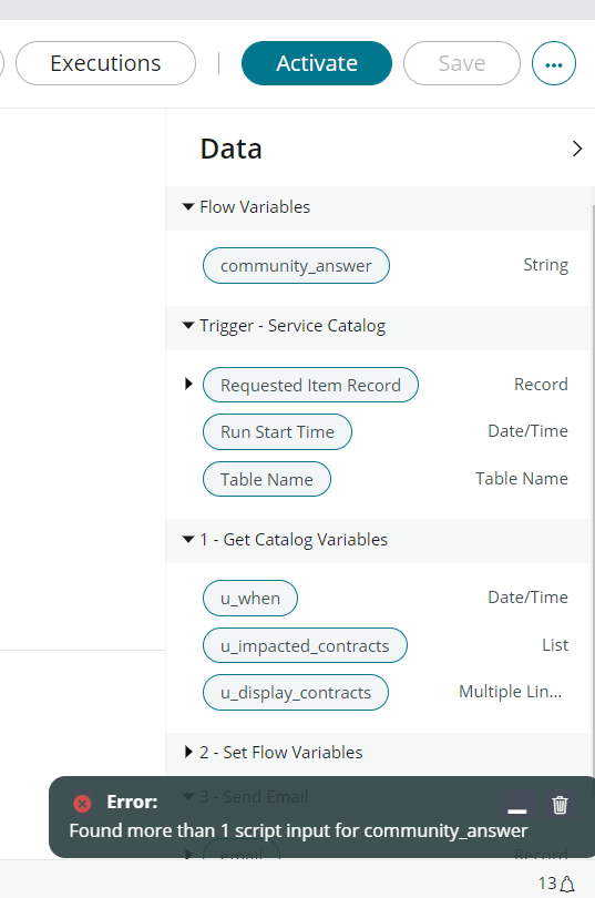

Hi @Muhammad Khan ,
I tried but I am unable to activate the flow, I am getting an error message
