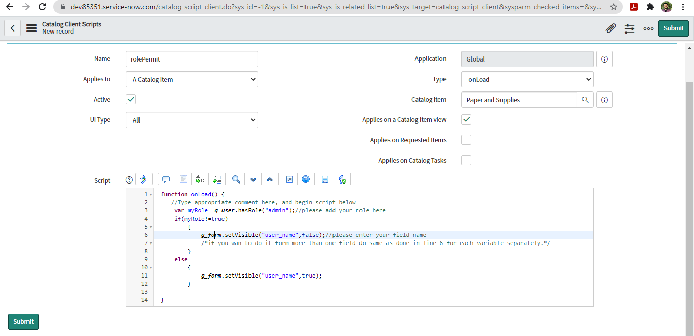

Hello
You need to write one onLoad Catalog Client Script in Your Catalog Item.
First Type  sc_cat_item.LIST in Application Navigator. your maintain item table will open in new tab.
open your catalog item in new tab by hold ctrl button and click on it.
Now in the bottom.
now here you have 2 concerns that you need to check?
1) is your variable is in Variable Set?
2) is your variable is available normally in Variable section i.e item_option_new table. like below.
first see case 2:-
find_real_file.pngthen you need to write onLoad Catalog Client Script 4th section of above image. Catalog Client Script.
click on new
write below script as given,
Case 1:-  if your variables are inside the Variable set then you need to perform this same in variable set.:-
Go to 2nd tab of variable set.
Select your variable set and open it. then follow same procedure only difference is you need to add your Variable Set name there.
Please Refer my Article on Role Selection. follow the client side user role section from my Article.
https://community.servicenow.com/community?id=community_article&sys_id=2750d18ddb85a0109e691ea668961...
Please Mark Correct and Helpful
Thanks and Regards
Gaurav Shirsat

Gaurav Shirsat
Hello
Now in the bottom.
first see case 2:-
click on new
Thanks and Regards
Gaurav Shirsat
