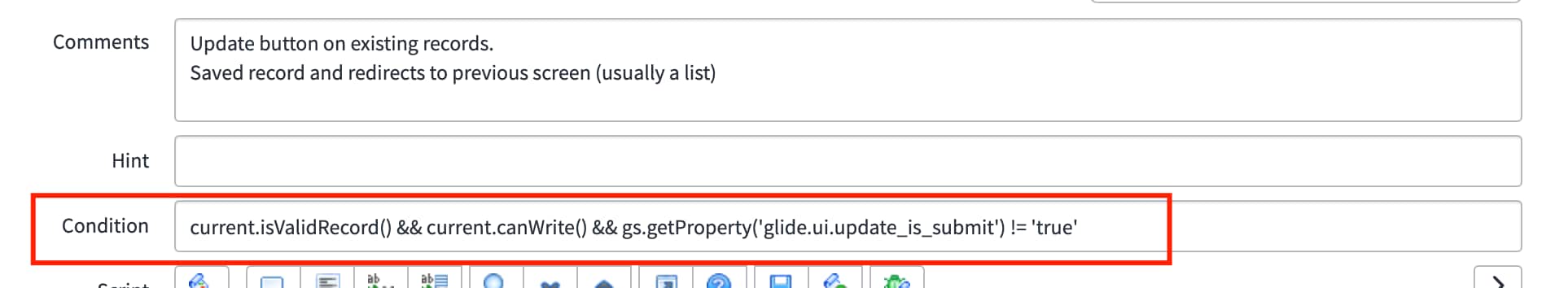

Have you tried looking at the conditions on the UI action you see as administrator? It could be a button for a specific user (such as admin). Also, when you add the admin role to your account, you have logged out and back in to make sure the roles update?
If there is a UI action for "Update" on the child table with the same action name as the parent table, it will override the parent table UI Action.

My only guess would be that some condition on the UI Action is preventing the created_by user from accessing the button. What is the condition on the UI Action?

Hi
Is exactly the same as in your bitmap i.e
current.isValidRecord() && current.canWrite() && gs.getProperty('glide.ui.update_is_submit') != 'true'
The settings I managed to capture on opening the form are as follows:
The user that I have the issue with:
errordebug:Mike MoveLead
isvalid=true
canwrite=true
glide.ui.update_is_submit=false
The user that works:
errordebug:System Administrator
isvalid=true
canwrite=true
So I do not think it is the condition. Plus this is happening as well with a generic UI Action as well.
