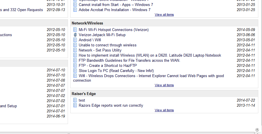

Hello I am new to SN and my first project is to create a Knowledge Base topic that users can add articles to, edit, etc. I figured out how to create it in Dev and created an update set and moved it to Test. However, my update set just changed the KB form, and my KB topic did not transfer over. I think I need to create a "new update set" for the new KB topic to be able to transfer it from Dev to test and test to Production?? How do I create a NEW update set, for a new KB topic? I am working in Aspen version

Knowledge base articles do not get transferred over with update sets. You need to make sure that you have an article in test with the topic of "Raiser's Edge".
