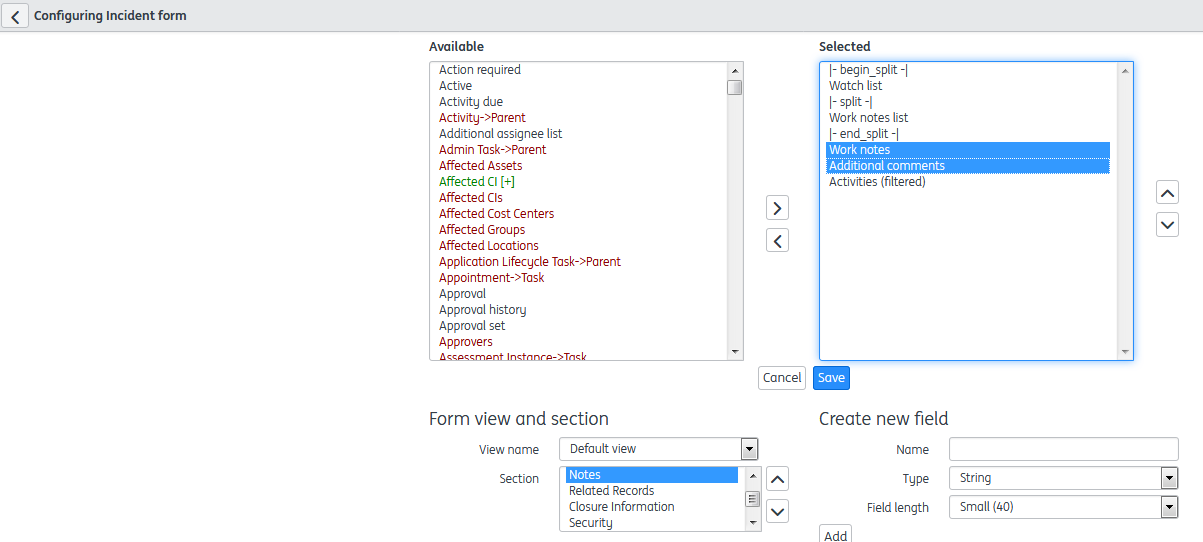

after some testing with form layouts and the configuration of the "Activities (filtered)" element on the form it seems to behave like following:
For new records: the order of the fields depend on the configuration done via "Configure - Form Layout" (or the form designer). See following screenshot - we prefer to have the "Work Notes" at first position to prevent accidentally adding (internal) work notes to the "Additional Comments" field
For existing records: For these the order seems to depend on how you configured the "Activities" element (assuming, you also use this element on the affected forms):
Stefan

Hi Wayne,
Stefan
Thanks Stefan. I'm going to configure my forms and see what happens.
This does indeed resolve my problem. However, the other issue on the Legal table (u_legal) where Draft appears above or below the journal feilds depending on the record state still exists:
