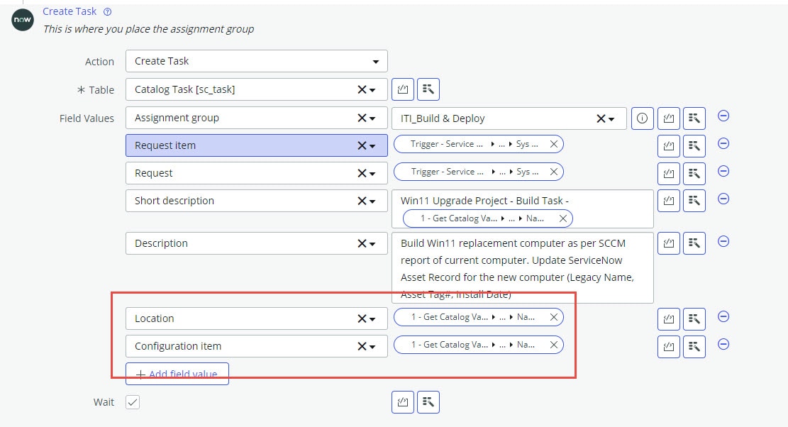

What is the trick to pass the config id and location variables to the SCTASK record with flow designer?
I have it set up like the image attached.  The config id and location fields are blank when I log a test task.

@ryan_kelly You can use "Create Catalog Task" instead of "Create Task"
Result : Populates the variable value.

I need to populate the Config ID and Location fields on the task form, not populate into short description field.  Can this be done?
Yes you can do it!  Drag and drop the appropriate variables on the catalog task activity.
Short description was an example to showcase that it can be done using catalog task activity.

I tried using 'create catalog task' but i am still getting the same results - blank config id and location fields in task.  Anything else I could be missing?
