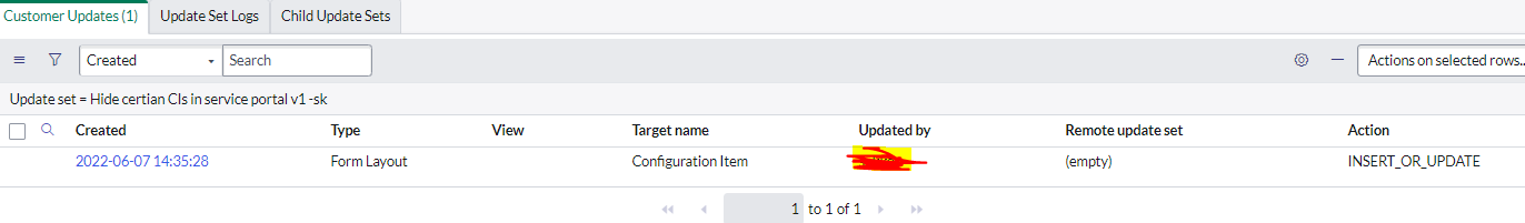

Using the class hierarchy manager, I created yes/no field for the base configuration item (cmdb_ci). I have the following questions.
1. In the list view I added the newly created column, but it is not showing
2. in the update set it is saving newly created attribute as form layout. It should be on the table as new field right?
Appreciate any help.

1) As Tony said, I think you have personalized the list view for table. Hence, you need to "Reset to columns Default",. After that it will reflect in list layout.
2) If you added new field on Form it will show 1 record for Form layout.
For table, in update set there will be dictionary record.

Thanks for the replies. I added like this using 'insert low'. What is right way to add new attribute to the cmdb_ci table
Hi -
My experience with adding fields at cmdb_ci with Class Manager is that it did not show up in my update set as a sys_dictionary entry. It’s only when I updated one of the dictionary attributes from the Dictionary Form (e.g., make it read-only) that the entry got added to the update set. I found this very confusing.
Hope it helps and if anyone has a different experience or knows a better way, please shout!
