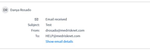

I recently opened a case with SNOW support due to problems with email flow. They had me uncheck the Stop Processing checkbox in the BP - Create Incident With Watchlist Inbound Action. That made it so that the contact type no longer populates. It now says None in the Channel dropdown (it used to add Email), and the body of the email isn't showing up as a comment anymore. We have to click Show email details in order to see the explanation of their issue. This is very inconvenient. I tried rechecking the Stop Processing checkbox and that hasn't fixed it. We do not have any scripts for the inbound actions. I have checked the Create Incident Inbound Action and since there's no script, it appears to be configured correctly. Please help!
