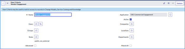

  • The catalog item(s) intended for unauthenticated submission must have a 'User Criteria' that allows access to the public role

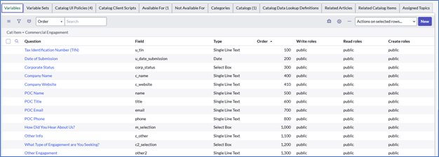

  • The variables must allow 'Create' permissions to the public role

    • Available for (tab) – Create or add ‘User Criteria’ record
Note: Role should be ‘public, snc_external’
    • Variables – make sure the write, read, and create roles are ‘publi’Magnum1_2-1698877636961.png
Note: Reference and List Collector variables must allow ‘Read’ access to that table content

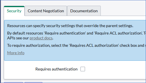

All the REST APIs used on the above mentioned widgets/pages must be configured to allow unauthenticated access by unchecking the `Requires Authentication` field in the REST API configuration. This includes the following API(s):

if you see the article it has mentioned to update the api method field "Requires Authentication" .
go to the scripted Rest API >> search for "Service Catalog API" >> you will see list of method (Resources tab), so make the changes to those method field "Requires Authentication"
Screenshot for an example for buy Item method.
