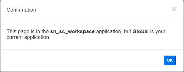

From Agent Workspace, from an Interaction record, I click the Create Request button and select a catalog item, the same way an agent would.
I observe the offending widgets on the right hand side of the page.
I Ctrl + Right Click on of the widgets.  (Super-hidden feature, by the way.)
I Choose "Page in Designer" to open up the "Service Portal Designer".
This brings me to the "Service Portal Designer".
I see the offending "Cool Clock" widget on the right hand side...
But I am unable to:
1) Drag it off of the page back into the Widgets pane.
2) Delete it with the delete button.
3) Drag it to a new position on the form.
I get the following error message:
But I don't see any way to change my current application to "sn_sc_workspac".  That does not exist in my application picker:
Where am I going wrong, or what am I not understanding?  Thanks!

I changed my Scope to "Service Catalog - Service Workspace"...
Then I open up the Service Portal Designer and I go to delete the widget from the page using the trash can icon at the top right of the clock in blue...
It asks me this...
I click Yes.  But then I still get the following:
Is this the normal way that Widgets are added to and removed from workspace pages?
