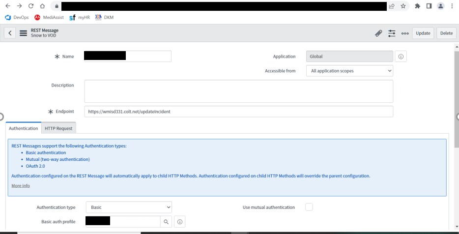

I am new to Integrations. I have created an Outbound rest message with HTTP Method PUT but getting error code:
Method failed: (/updateIncident) with code: 400
and response: [ISS.0086.9249] Missing Parameter: document
I have checked the connectivity through Postman as well and it is working fine.
Checked Postman connectivity at 3rd party end and that is also fine. I am able to receive the data from third party but not able to send the data. Below are the snapshots for Rest Message and Business rule:
Rest Message:
Business Rule:
Kindly let me know where and what I am doing wrong. In Dev environment it is working fine.

can you show me the snapshot of http request form section? n compare it with your dev. are you missing some headers

You don't need to set set Endpoint explicitly as you have already configured in in Rest Message.
As you have mentioned it is working in Dev then please check the endpoints and body in DEV.
Also can you please share postman configuration? what was endpoint and body you were using there?

Hi Anil,
Thanks for reply. Yes everything is same in DEV. In Body I am giving json. Below is the postman configuration:
