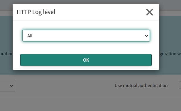

and check logs in Outbound HTTP Requests module:
Anil Lande
