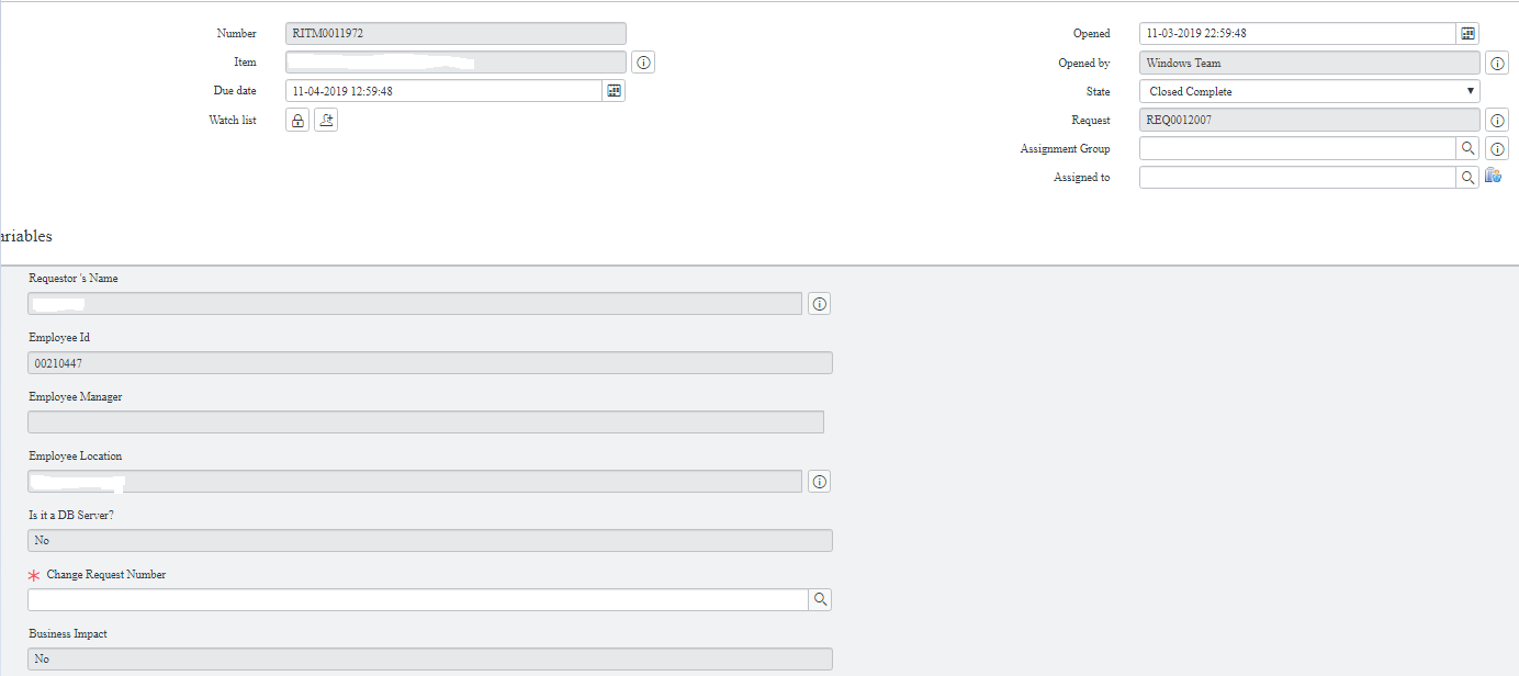

RITM is getting closed even if the mandatory fields are not filled this is happening with the workflow. But when i manually try to close the RITM i am getting the mandatory field to be filled alert.

12-11-2019 10:05 PM
Hi Ankur,
The variable is a reference field to the change request table the variable change request field can be filled at any time after the catalog is submitted. The RITM is getting closed by the workflow. The below script does that once all the SCTASK are closed.
