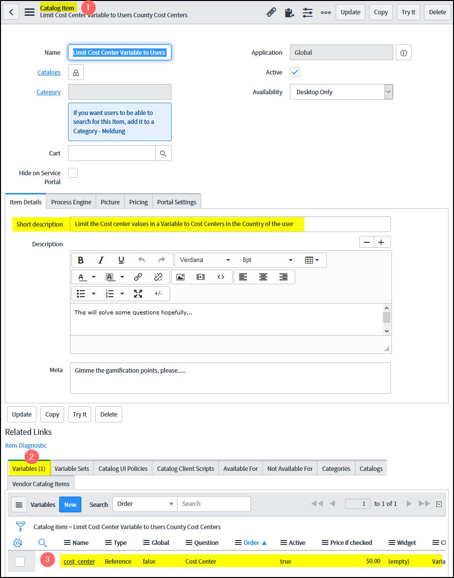

2) Create a Test-Catalog Item
The Catalog Item (1) will need a Catalog Variable (2) which I called "cost_center" (3) - see details in the screenshot below.
Set the Variable (1) to "Type" = "Reference" and enter the Question (3).
On the "Type Specifications" Tab, set the "Reference" field to the "Cost Center" (cmn_cost_center) table.
Set the "Use reference qualifier" field to "Advanced" (3).
Enter the Value shown in the "Reference qualifier" (4) field as shown in the screenshot below. This will use the Script Include created above to create the filter for the Lookup list.
Copy it from here:
javascript:new DirkCountryCostCenterRefQual().getData(current)

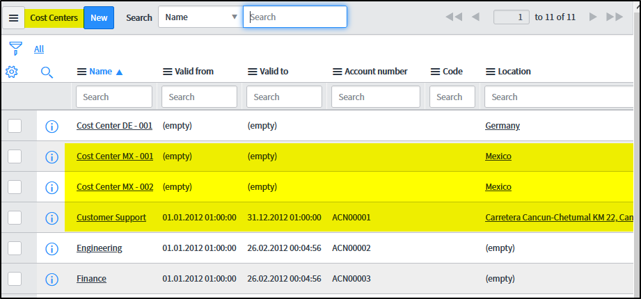

4) Create Test records
The User is configured like shown below:
The used Location is set up like:
You can see, that the "Country" field is set up as "Mexico" (1).
The following marked three Cost Centers are using Locations, where the Country is set to "Mexico". These will be the Cost Centers shown in the reference List (Catalog Variable) below:
5) Finally earn your fruits
Test your catalog Item and open the reference List:
It will show only the matching and desired records.
Copy it from here:

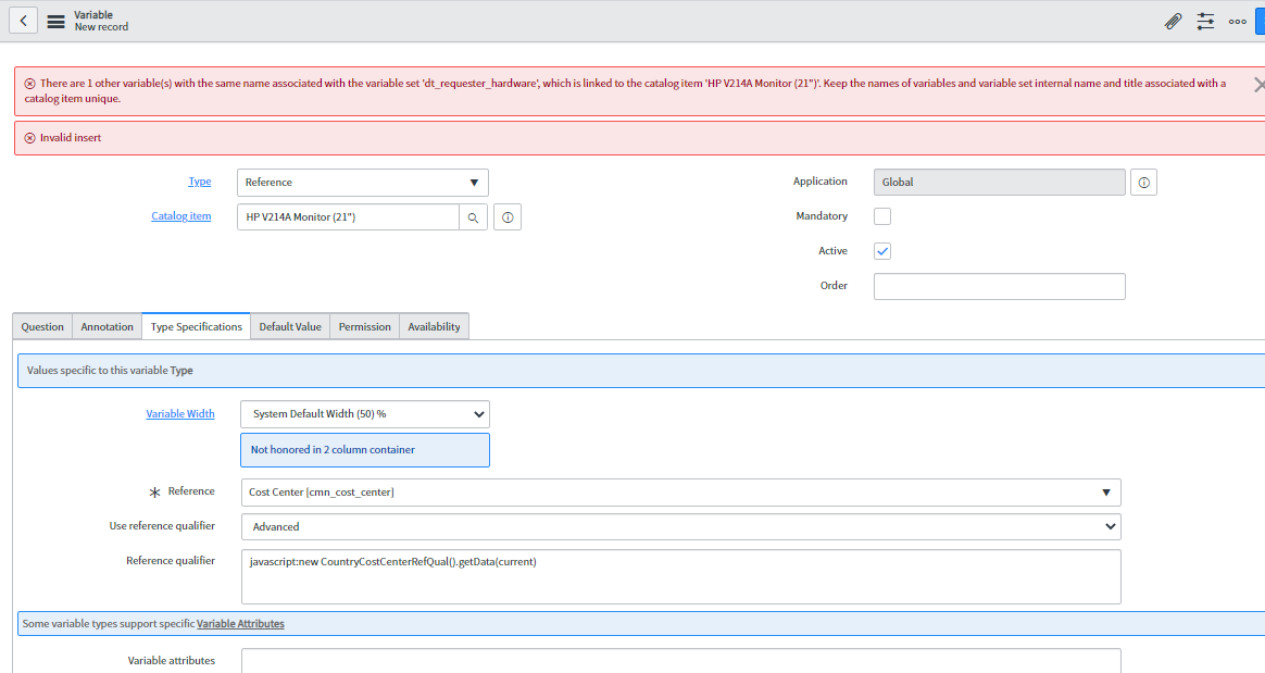

I have followed the steps this morning and they don't seem to be limiting the Cost Center to the Users country. I have repeated the steps numerous times so not sure if this is an issue with a local set up of our system or something I may of missed. I have attached screen shots of this set up locally, if you could have a look and see if this is correct as you would expect it to work.
When I run the catalog and look at the new item, it shows all Cost Centers, not just the ones limited to the user country
Also, when I try to add this to an existing item that is set up, it gives the following error so not sure how viable this is for our set up.

Hi Alex
I just reviewed your Word File and at least I can see, that I understood your question correctly and my steps towards the solution are the right direction.
First of all, I want to mention, that the screenshot above indicates, that you have a Variable with the SAME name in a "Variable Set", which seems to be allocated to your catalog Items.
You need to make sure, that the variable names are UNIQUE
Second, as I found out, you tested your solution in the Portal, where I tested that in the Classic UI, but I will cross-check that - I think (hope) it should work the same; in Backend and Frontend (Portal).
Maybe you do NOT see/use the NEW Variable that you just created when accessing your Test Item in the Portal. Because of the error message above states, that you already have another variable with the same name attached via "Variable Set".
Maybe you just create another new Catalog Item with NO other Variable then your test "Cost Center" variable.
Can you confirm that test above?
Let me know if that solves your issue, while I start testing it in the Portal.
