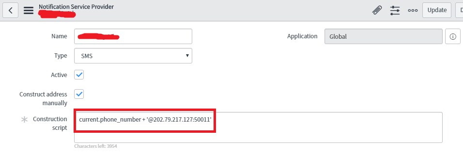

We have the following requirements:
1. Configure SMS notifications (without Notify)
The customer has their own SMS gateway available, but only on-premise. To get around this problem, we have successfully set up a VPN to reach the SMS gateway. However, the address for the SMS gateway has a port number, and this seems to be causing some parsing errors within the platform. The SMS server itself is not receiving any packages from ServiceNow, so it seems that ServiceNow is not even able to correctly establish a connection with the SMS server. It does not seem to be an issue with the VPN setup either, as both ServiceNow and the customer have verified during the VPN setup that the tunnel has been created correctly. Any solutions we can use to make this possible? Pics attached below:

Any ideas on the SMS situation? From what I can see, the error message is that there are no recipients even though the recipient field has been populated with "<phone_number>@<SMS_server_address>". Does this mean that there is an issue with parsing the field? We have also checked the traffic logs on the SMS server and are not seeing any messages originating from the ServiceNow instance, so it sounds like ServiceNow is not actually attempting to send anything to the SMS server to begin with.
