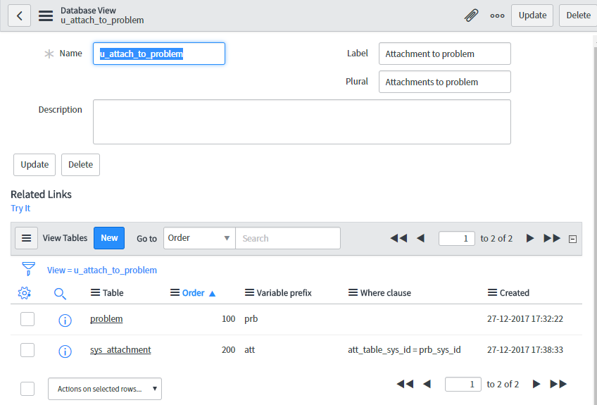

I have a need to report on Problems that contains an attachment with a specific tags (RCA in this case).
So, my initial idea was:
- to create a database view with the table problem and the table sys_attachment.
- and then report on that database view for all attachment linked to a problem that contains the specific tags
The problem is that when creating a DB view it seems the Tag field is not properly searchable.
This is my DB view definition:
(i restricted the field returned to make sure i only return the sys_tags field of the sys_attachment table and not the one of the problem table)
I then created a report on the db view "u_attach_to_problem" and looked for entries with sys_tags = RCA, but then, the report returns all entries, not considering my filter.
Please also note that the field available for reporting is not called "Tags", but "sys_tags", the field name, not the Label...strange
I verified the sys_attachment table for an attachment containing the "RCA" tags linked to table "problem". And found only one, so i should get only one hit in my report
The last verification i did was to take that sys_attachment entry's sys_id and searched in my report for the record with that sys_id.
That record was found, but the sys_tags field displayed was empty...so i think my issue is there, but i can't find a way to resolve it.
Does anyone has a magical solution to this or should i create an hi ticket?

‎12-28-2017 02:17 AM
Hey Marcus,
Tags are stored in table "label" and once we add a tag to a ticket or anything, that gets stored in "label_entry" table. If you look at the "label" table you will get the idea.
Kannan

‎12-28-2017 02:30 AM
I searched the dictionary for all table with the keyword tag to try to find that info.
This is the building block i was missing 🙂
Thank you !!
