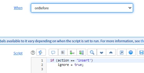

I am trying to update email, phone and location only if there is no existing value for the field. I see that existing value is being updated by new value. Please let me know if I am missing anything.
I created a transform map as follow
I have the following in my onBefore transform scripts

If you are using a script to populate the values you should be able to remove all the filed mappings expect the field on which you are coalescing.
Please give it a try and provide feedback.

like Tudor mentioned, you have those fields and the coalesce in the field mapping , that means any fields in those mapping will be updated so remove the fields from the mapping and keep the scripts.
