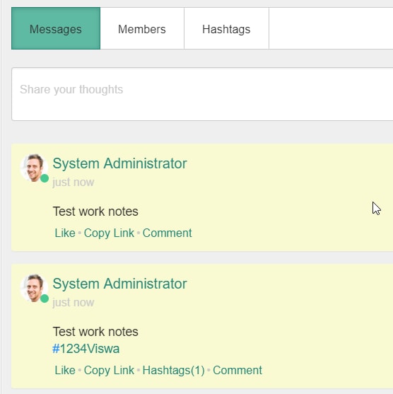

For each note, I would like to add a hash tag. For achieving this, I have have created a before business rule on the task form and appending the work_notes with tag name
BEFORE business rule (Order 100)
// Add your code here
current.work_notes = current.work_notes+"\n#1234Viswa";
})(current, previous);
But when I enter a work note, I see two entries. One with the entered value, the other with the hastag. Is it possible to have only journal record entry ?

modifying Journal Fields is a bit tricky and not easy to do as they act different to normal fields, that don't track a journal on their own. My suggestion is, that you do this kind of manipulation in an onSubmit Client Script. This doesn't cost much time (takes immediate effect) and you're working around the Journal Field Type exceptions...
Of course, this depends on what you want to do... as long as the hashtag generation doesn't require additional server-side available information (e.g. information from other Records in the system), a client-side script is completely fine for this jobs. If you need to do additional queries, e.g. in AJAX calls, there might be a slight delay before the actual submit if you are taking this direction.

can you try with below line
current.work_notes.setJournalEntry('\n#1234Viswa');
Internally, setJournalEntry just calls setDisplayValue -- so they can be used synonymously.
Because Journal Fields are handled internally using an ArrayList and both functions actually call the add Function of the ArrayList, the underlaying problem is that this also results in a new record in sys_journal_field for each "setJournalEntry" call.
As for rendering purposes the created sys_journal_field records are reverse ordered (the most current displayed on top), using these functions also basically prepends the supplied text instead of appending it. This not only results in prepended text in the UI, but also in the audit and history, as these two depend on the "rendered" value...
So the safest way to do this, really is to do it on client-side...
