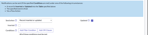

This is my when to send notification record now how do i define the trigger logic here?? I am confused.

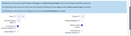

This is my who will receive notification record there no users nor groups given now how and which recipient should i take it???

under the Send when - it is either fired by event or with conditions that you build after changing that field:
In your screenshot, here:
EDIT: the condition is below the marked field, just add the field and assign values

PoonkodiS
In simple terms:
1. Record Inserted or Updated
Use when a record changes.
  • A new record is created → send a notification.
  • An existing record is updated → send a notification.
Example:
When an Incident is created, email the Service Desk.
2. Event is Fired
Use when a script or process tells ServiceNow to send a notification.
  • A Business Rule, Scheduled Job, or script creates an event.
  • The notification listens for that event.
Example:
A scheduled job checks contracts every day and fires an event when a contract is 7 days from expiring.
3. Triggered
Use when Flow Designer controls the notification.
  • A flow reaches a step that sends an email.
  • Everything is managed inside the flow.
Example:
An approval flow sends an email to a manager for approval.
For reference: https://blog.snowycode.com/post/how-to-create-an-email-notification-in-servicenow

For Who will receive tab:
1.Users
You manually choose specific people.
2.Groups
You choose a group.
Example: Send the email to the Service Desk group.
 Everyone in that group gets the email.
3.Users/Groups in Fields
ServiceNow looks at the record and finds the recipient.
4.Send to Event Creator
Controls whether the person who caused the notification gets the email.
Example:
  • Bob updates an incident.
  • Notification is triggered.
  • Checked → Bob gets the email.
    5.Event Parm 1 / Event Parm 2
    Used with Event is Fired notifications.
    A script tells ServiceNow who should get the email.
