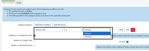

EdmarM
Options on the third drop down is not visible what may be the problem?

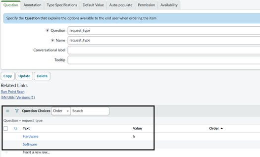

Hello @EdmarM ,
plz make ensure that the varible has choices configured :
Then you will get options :
EdmarM
After checking I was not able to put value/options on the Select Type of Request Variable that's why there is no option appearing when I am clicking the dropdown box.
