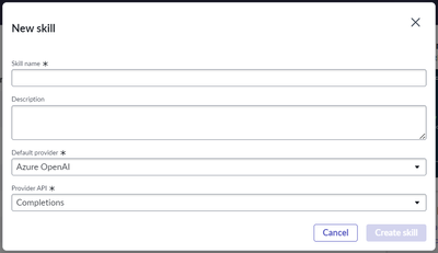

I want to configure Now Assist Skill Kit with Azure OpenAI provider, looking for any documentation or video example where step by step instructions are mentioned on how to set up this.

To answer your question directly, all you need to do to build against Azure OpenAI is to navigate to Workflow Studio, click on integrations, click on connections, search for the Azure OpenAI tile, click on Add Connection and enter your API Key (yes it's that simple!)
Once you have done that you can create a skill against the Azure OpenAI provider.
