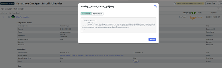

I am creating standard change requests dynamically in a Flow Designer flow in response to a user submitting a RITM. The flow is configured to wait until the change's state is closed or cancelled, and update / close the RITM accordingly. However, I get a confusing error in the Wait for Condition step.
Here is the Wait for Condition part of the flow, along with the error details:
Will appreciate any advice on how to avoid / handle this error.

Yeah indeed, I’ve run into this with Flow Designer before. The “Wait for Condition” step is picky about what it can “hold onto” while the flow is paused.
What’s happening is: you’re probably feeding the Wait step a record object/data pill coming back from the “Create Change” action. When the flow pauses, it has to store that value so it can resume later, and sometimes that record object doesn’t serialize cleanly—so you get that confusing [object] / action_status error.
What usually fixes it is a small change in approach:
  1. Right after you create the Change, store only the sys_id in a string variable
  2. Do a Look Up Record on change_request using that sys_id
  3. Use the Look Up Record output as the “Record” for the Wait for Condition step (wait until state is Closed/Canceled)
Same logic, but instead of trying to “pause” with a complex object, the flow pauses with just an ID and re-loads the record cleanly.

This sounds like a great idea, but unfortunately it didn't work:
It's as if this change request is created, but its attributes are not available in the flow. What can possibly be the reason? And most importantly, is there anything I can do to fix it?

I don't think that's where the problem is. I made changes to only capture the sys_id of the change. The change is created successfully, but when I try to store its sys_id in the flow variable, it comes out empty, as can be seen in the screenshot below:
Still at a loss...
