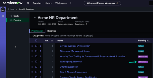

I am doing it through one of the out of the box lens "organization lens" for demands. What's odd is that If I go to planning items I see many demands, but in APW there isn't anything in the department field, but if I open the demand in the field called department there is data.  In the APW world where is it getting the department field?
mcastoe
HI,
APW is using the Department Reference from the Demand. After you create your plan, if you click on the Prioritization tab, do you see anything listed?
If so, then you only need to set the record(s) to prioritized for them to show in the Roadmap.   If you are not seeing anything, try going to the Alignment Planner Workspace > Integrations list and open the ServiceNow Integration.
Once you are in the Integration form, click the Import button to force population of planning items.
hope this helps,
Mark
