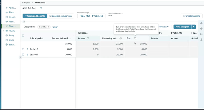

You should be able to view these values directly within the Project Workspace for the sub-project -> Financials.

So, to summarize: If you're looking for the classic ETC/EAC labels, check the Project Workspace financial views and use the information (i) icons next to the financial metrics to review the formulas being applied. While the terminology has changed, the equivalent metrics are still calculated at the sub-project level - screenshot below.

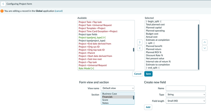

However, for the sub project, on the classic UI , these fields are not displayed on the UI.. Though you can see them in the selected section, in case you try to configure the Form Layout of the sub project; screenshot below. I am sharing all this information to keep the users posted that this is out of the box behavior for the sub project and you should not feel as if you are doing something incorrect.

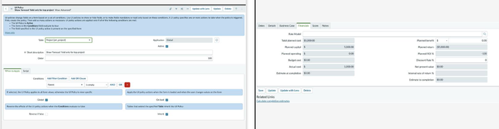

Additional Information to keep you posted on the Behavior - There is a UI Policy "Show 'forecast' field only for top project".
After unchecking ""Reverse if false"", you would start getting the fields - "Estimate at completion" and "Estimate to complete" - on the subproject; screenshots below.
But even after clicking on the related link - Calculate Completion Estimates - the ETC and EAC fields would display 0 for the subproject....
