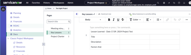

09-17-2024 05:32 AM
Hello @Brian Gadeberg , @Christian Dietr I think usage of the 'Docs' feature in the new project workspace could be an option too as it enable usage of templates and (if reporting is not required to be done on such objects)?
