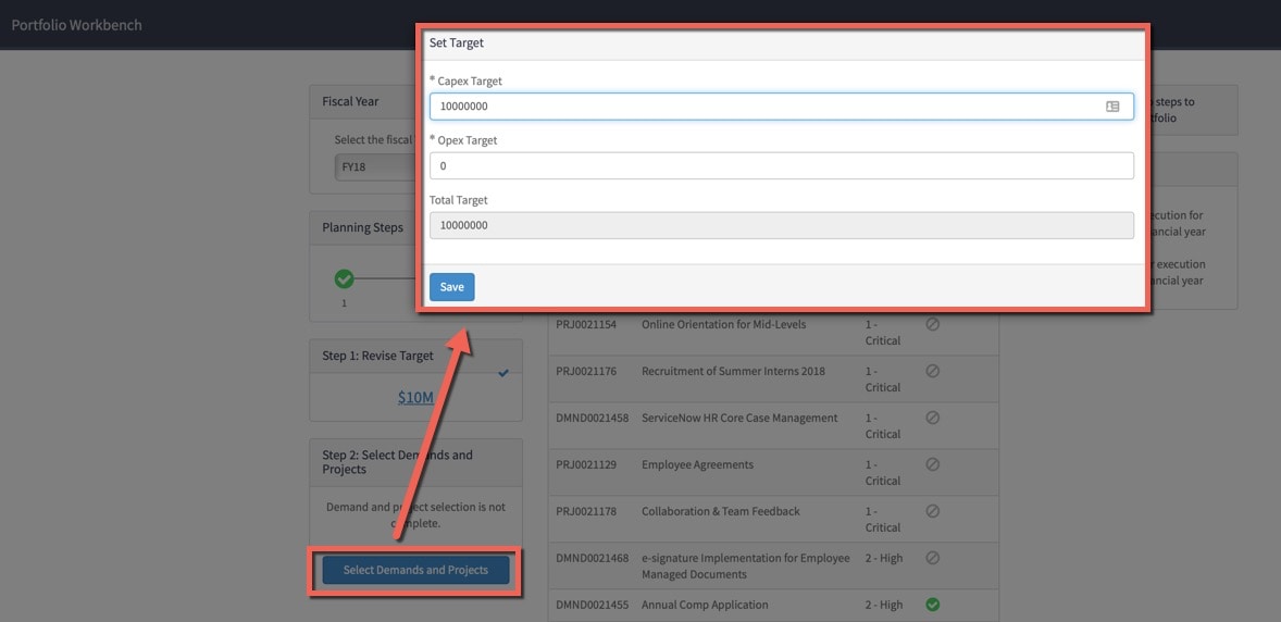

When you set the targets and budgets you are able to both OPEX and CAPEX (Portfolio Workbench)
