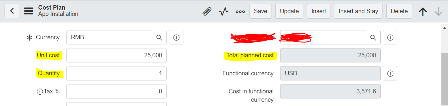

How Cost plan related Cost break downs are calculated ?
One user reported that , Cost plan of FY22 all months break down "Entered cost and functional cost" updated automatically
Where its get updated ? where calculates the value ?
@Sukran  - You fiscal period for above screenshot seems to be 20 months
Calculation logic of Total planned cost
Now you manually enter Unit cost and quanitty
Servicenow will automatically calculate Total planned cost as Unit cost*quanitity = 25000*1 = 25000
Calculation logic of Entered cost
Now the on cost plan breakdown's entered cost is calculated as Total Planned cost/Fiscal period (in months)
= 25000/20 = 1250
ts gets updated at at : cost_plan_breakdown table.
Functional cost uses Exchange rate is used to convert entered cost into functional cost. It is obtained from the itfm_fx_rate [budget_reference_rates] table.
Please let me know if this clarifies.

@Rajesh Singh  Thanks , But our quantity as 1 , but when total planned cost is changed
its applied automatically entire months FY21 Start and FY22 DEC with calculates

@Rajesh Singh Checked its manual creation
Its due to manual creation ?
Cost Plan Screenshot:
Cost break down
