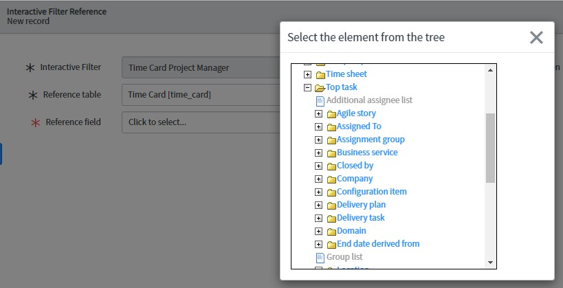

We need to create an interactive filter to filter the Time Card report based on Project Manager.
I have created an interactive filter on sys_user table and tried to dot walk through Top Task field on Time card but it is not displaying Project Related fields:
I am able to filter out the Time cards from List view as there is an option to go to Project fields from Top Task using Project(+) but it is not available for Interactive filter Reference.
Please let me know if any one have any idea to achieve it.

Hi Prabhh,
Unfortunately it is not possible to select extended tables in that picker for interactive filters.
I do have an undocumented feature/work around for this. You need to open the interactive filter and do list editing on the reference field for that relevant entry, so in the related list of the interactive filter. When doing the list edit you would need to type the complete technical name of the relation correct. I believe it was;
top_task.ref_pm_project.project_manager
Regards roel

Thank you @Roel
It worked!! 🙂
