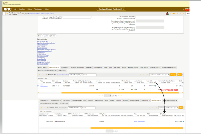

Can you help me to guide, why the value is different when field added to view as reference field?
Problem Statement: On [Expense Lines] entity's view I have added a reference column "TimeCard.ResourcePlan.SalesRates", which is showing value in base currency and not the value!
Expected outcome: column "TimeCard.ResourcePlan.SalesRates" should show value as there on resource plan that is Project specific currency
Actual outcome: column "TimeCard.ResourcePlan.SalesRates" is behaving wired as the value is appearing in converted base currency rather than as specified in project.resourceplan!

Would be really helpful if I get the confirmation that currency field(when created custom) behaves the same way as mentioned in problem statement, by design? So accordingly I can raise the ticket with SNC and for now check on suggested workaround.
I just want to be sure that this is by design/function or not.
shikhagrover
Thanks a lot for taking time, looking into the problem and suggesting the workaround.
As suggested, I have verified the table references and column settings all are good as offered by SNC. Even though this Currency field(Saled Rate) when referred (as dot walked) is showing the behavior that is such column shows stored value (value stored table with base currency and not as per project currency).
Could you reproduce same behaviour on PDI and confirm if this is by design? As suggested workaround would be an overhead on system to get the values.
