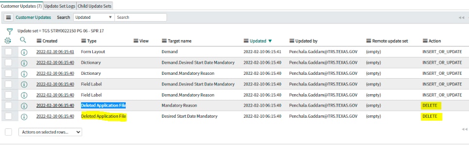

I have a requirement to create 3 fields on the demand form as follows
1. desired start date mandatory (True/False)
2. desired End date mandatory (True/False)
3. Mandatory reason (String)
Whenever i create field on the demand form it is getting created and in the background it is deleting an application which is captured in my update set. Because of this issue if move my update set to Test instance i am unable to see these fields on the form where as in the table i see these fields available with out Label.
CCan some one help me out of these
02-10-2022 06:43 AM
02-10-2022 06:49 AM
ideally it should not capture that.
Did you try removing those customer updates from your xml and then try to migrate?
