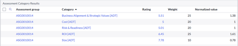

The Populate Metric Results business rule and associated script include function DemandUtil.populateScore take the results of the script and question based metrics and populate them into their respective scoring fields:
  1. score_size
  2. score_strategic_alignment (not shown on demand form by default)
  3. score_risk
  4. score_value
  5. score_cost (not shown on demand form by default)
Thereafter, as documented, the EntityScorer and ScoreCalculator script include are calculating the Score as:
score = ((10 - score_risk) + (10 - score_size) + score_value) / 3
So, based on this the score_strategic_alignment and score_cost values are just ignored? What are we supposed to do with them - eyeball the metric results for these categories, and manually adjust the priority on SPW or something?

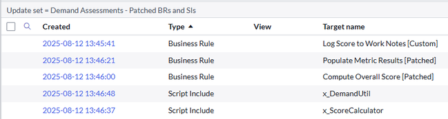

For anyone that does want complete and accurate demand scoring, my team and I have worked on some patched versions of the Business Rules and Script Include to correct the flaws mentioned above.
The attached Update Set includes the following items, which I'll explain in detail below.
The patched Business Rules are ordered to execute immediately after the OOTB ones, so that you can leave them untouched if you want. This also means that you can apply additional conditions if you only want the corrected scoring to work for specific types of demands, portfolios, etc. Also included is an additional Business Rule that leverages the new score calculator to write notes to the demand to show the score workings.

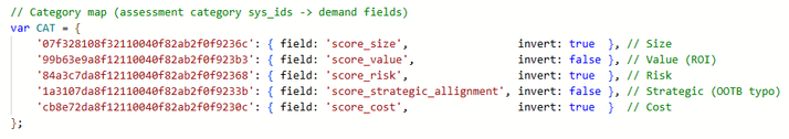

2. Script Include: x_DemandUtil
  • Makes use of constants and variables to define sys_ids for Metric Type and Category references, instead of repeated, hard-coded ones. This allows you to clone and update easily for any customer-specific metric types and categories.
  • Variable-based choice between using the Rating or Normalized Value scores from assessment category results. Rating remains default (like OOTB), since you can't use Normalized Values if you intend to also use the Demand Workbench. But, you have the option to present Normalized Scores in the demand.
  • Cleaner/more robust code for collecting and populating metrics per category. i.e. relies on variables and loops, instead of fixed IF statements with hard-coded values. Again, this allows you to add/remove/customize categories easily without having to worry about updating multiple parts of the code.

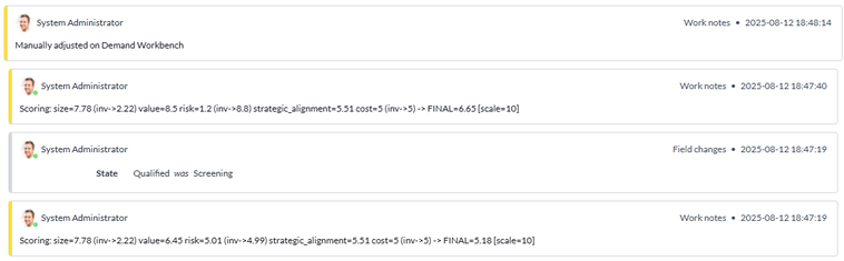

5. Business Rule: Log Score to Work Notes [Custom]
  • Business rule to retrieve Breakdowns from the x_ScoreCalculator and log the score workings to the Work Notes journal in the Demand.
  • This has the additional benefit of tracking changes to the demand score, especially if the demand is manually adjusted on the Demand Workbench
