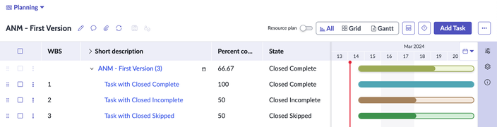

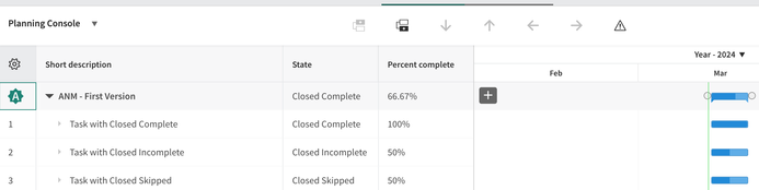

Please refer below screenshots:
Legacy Planing Console:
NPW:
Hope this answers the points. If it does, please mark it as correct answer.
Happy SPM Journey !!
