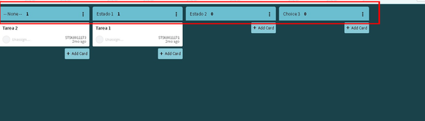

Hello people!
I have a simple question...
Do you know what is the table for an agile board? I need to build a report with stories and COLUMNS. If a build it with the stories table I won'tt be able to see the columns so I need to get the agile board table
Thank you!!!
AndersBGS
Hi @Leonel Sandroni ,
The visual taskboard table is vtb_board where there is a relation to the rm_story table as task table and an related list to vtb_lane, which is the visual taskboard columns:
