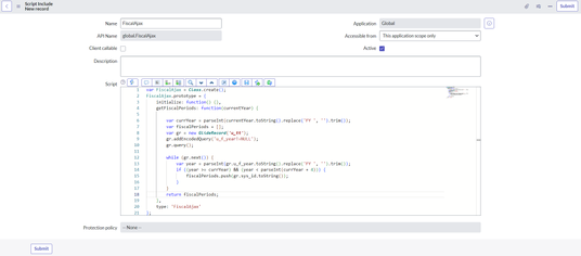

- Create a script include with below code
var FiscalAjax = Class.create();
FiscalAjax.prototype = {
    initialize: function() {},
    getFiscalPeriods: function(currentYear) {
        var currYear = parseInt(currentYear.toString().replace('FY ', '').trim());
        var fiscalPeriods = [];
        var gr = new GlideRecord('fiscal_period');
        gr.addEncodedQuery('Add your Query');// fiscal type is year & open is true
        gr.query();
        while (gr.next()) {
            var year = parseInt(gr.u_f_year.toString().replace('FY ', '').trim());
            if ((year >= currYear) && (year < parseInt(currYear + 4))) {
                fiscalPeriods.push(gr.sys_id.toString());
        return fiscalPeriods;
    type: 'FiscalAjax'

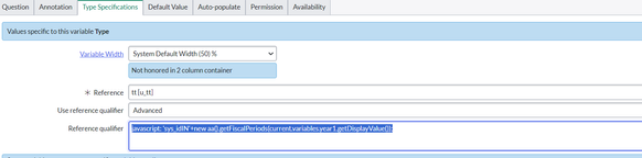

- In your second variable (start_fiscal_period_cap), add below in reference qualifier
javascript&colon; 'sys_idIN'+new FiscalAjax().getFiscalPeriods(current.variables.select_fiscal_year.getDisplayValue());

Use the above code to achieve your requirement. Tested in PDI

@RCA For the second field, you need to write a script include based reference qualifier. This reference qualifier will take first variable as input and will return the sys_id of those records which are no more than 4 years out from the current year.
To know more about advanced qualifier please refer to this post https://www.servicenow.com/community/developer-articles/reference-qualifiers-in-servicenow/ta-p/2765... and check the Advanced qualifier section.

Thanks Sai for the assistance!!! huge Help. For clarity in my particular case, the below is the code provided by Sai but modified to fit my variables.
Variable 1 reference field : select_fiscal_year  .Points to PPM OOTB table fiscal_period with simple condition Fiscal Type is Year and Open is True
Variable 2 field: start_fiscal_period_cap  .Points to PPM OOTB table fiscal_period with Advanced Use reference qualifier.
Script:
Script inlcude:
		gs.addErrorMessage(currentYear);
        var currYear = parseInt(currentYear.toString().replace('FY', '').trim());
        gr.addEncodedQuery('fiscal_type=year^open=true');// fiscal type is year & open is true
        gr.query();
        while (gr.next()) {
            var year = parseInt(gr.name.toString().replace('FY', '').trim());
            if ((year >= currYear) && (year < parseInt(currYear + 5))) {  // set to 5 to include current year plus 4 out years.
