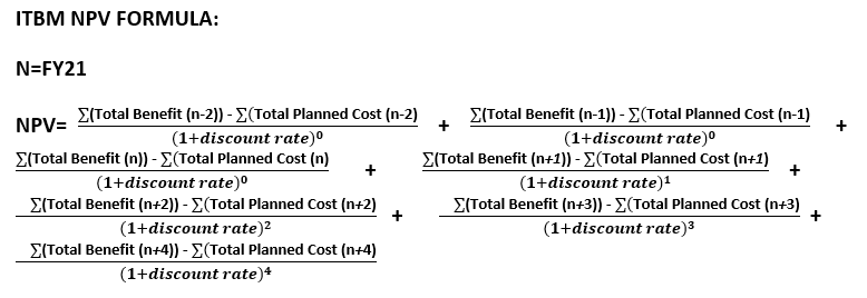

I have found many articles on it but still not able to actually get the calculation work which gives the result as the populated number in NPV.
I see the formula many places but what is the t in the formulas]? Time period then what, year of the cost plan or fiscal period?
Any detailed example?

This is the current NPV formula:

Can you point me where this script is written.
Q 1. So whatever you have in formula it is all exactly as it is?
Q 2. What will be the value of n?
Hi Chandler, The script is "IRRAndNPVAPI". N represents the current year. You also need to check for other script includes invoking the one I mentioned. I'm not in front of the laptop, so I cannot point it out right now. Please let me know if you need my assistance in this subject! Best Regards, Filipe Cruz

Hi Chandler,
Please find the below example to understand how NPV is calculated:
Total planned cost of FY22 (Current year): 180000
Total planned benefit of FY22 (Current year): 240000
Total planned cost of FY23 (Current year + 1): 180000
Total planned benefit of FY22 (Current year + 1): 240000
ROI = Total Planned Benefit - Total Planned cost = 480000-360000 = 120000
NPV = (240000-180000) + [(240000-180000)/(1+0.11)] = 114054
The discount rate is applied to the planned cost and benefits amount for future calendar year to the power of difference between the future year and the current year, which in the above example is 1.
