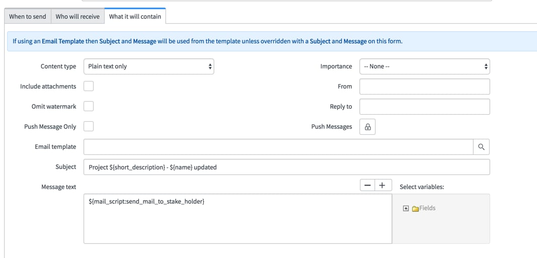

Now in the Notifications I do the following
In the message text - notice that I am doing ${mail_script: send_mail_to_stake_holder} which would be my mail script
In the Who will receive tab, give some default address for the TO.
Stakeholders will be added in the CC of the email, as you can see email.addAddress in line 9 of the script

You have to use Mail Scripts for that
http://wiki.servicenow.com/?title=Scripting_for_Email_Notifications#gsc.tab=0
If you see in the script I have current project record, I can write a logic to get all stakeholders email using simple joins.
thx that worked!
