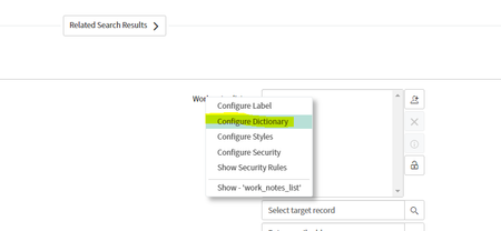

Is it possible to hide this button that appears in the list field?

1) Right Click on the field and select configure dictionary :

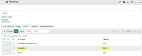

2) Add attribute 'No multiple' and add value true:
Please mark correct/helpful if this helps you!

1. Right click on the field from where you need to remove the highlighted button
2. And add the below attribute in the 'Attribute' field of your opened configuration form as below:
3. Update the form to save the changes.
After making this change, the button will be removed from that configured field as below:

Continued from my previous comment, Please update the dictionary entry for your field as below:
After making this change, the button will be removed from that configured field as required.

Hello @bonsai,
You can add that attribute directly into the 'Attribute' field or also from the related list 'Attributes'. By adding the value 'no_multiple=true' directly into the 'Attribute' field will automatically create the record into the 'Attribute' related list. So you can use any of the method to add the new attribute to remove the highlighted button from the required field.
