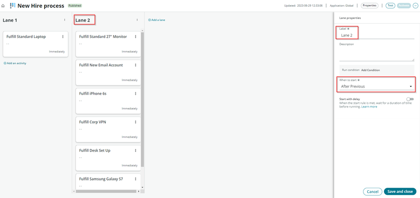

I am playing around with Order Guide sequencing in my developer instance to see if this will work for something we are trying to implement in our environment. The video on the plugin seems very straight forward, but I'm not getting the expected result and was hoping someone might be able to tell me why.

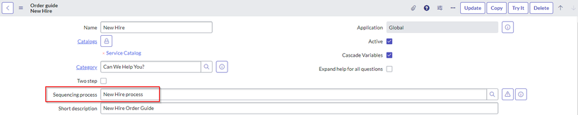

In my developer instance I've enabled the plugin. In the out of box order guide called "New Hire", I created a sequencing process called "New Hire process" and it is tied to the order guide.
In the Process Automation Designer, Lane 1 is set to start immediately and does not have a run condition. Lane 2 on the other hand is configured to start after the previous lane. Also no run condition.

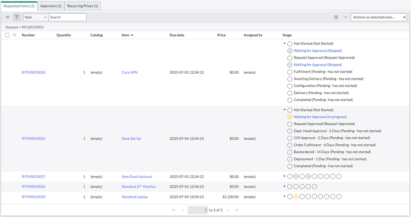

Unless I'm missing something, the tasks in lane 2 shouldn't start until the tasks in lane 1 are completed. However, when I submit the order guide, all of the requests are generated and instead of being in the "Not Started" stage, they either start to create tasks or approval records and are not respecting the sequence.
