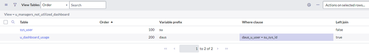

Hi @Tim_D ,
Just made some modifications in my PDI according to your requirement based on Adams table.
Based on below view, you can see that admin have accessed the dashboard twice, where abel have not visited it due to that item has never been created on dashboard usage table.
This is done by:
1. implementing Adams table.
2. make a database view linking "dashboard usage"(new table) and sys_user table:
off course, there could be some minor twerks to the overall configuration according to your needs, but I do see that this will work.

Hi @Tim_D ,
This is done by:

Tim_D
Hi Anders,
Thank you for your help.  I can see that this will do what I need.  I had begun wondering about a database view to accomplish it.  This is a great first step for what I need!
I am always concerned about creating new tables that may have licensing impacts so I may try building a database view between the sys_user or sys_user_group table and the Navigation history table.  This may give me a broader range of reporting opportunities, but I'm a little leery of using the History table in a DB view.
