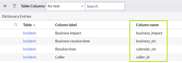

The names of the fields which you have used with current object and gr are incorrect.
Please use the backend column names of these fields.
In the table columns, please bring "column name " field as well from where you will be able to get the correct name of the field as shown below example. You have to take the name of the field from "Column name" column.
You always have to use the correct backend names, otherwise the system will not understand which field to copy and the record will be empty
