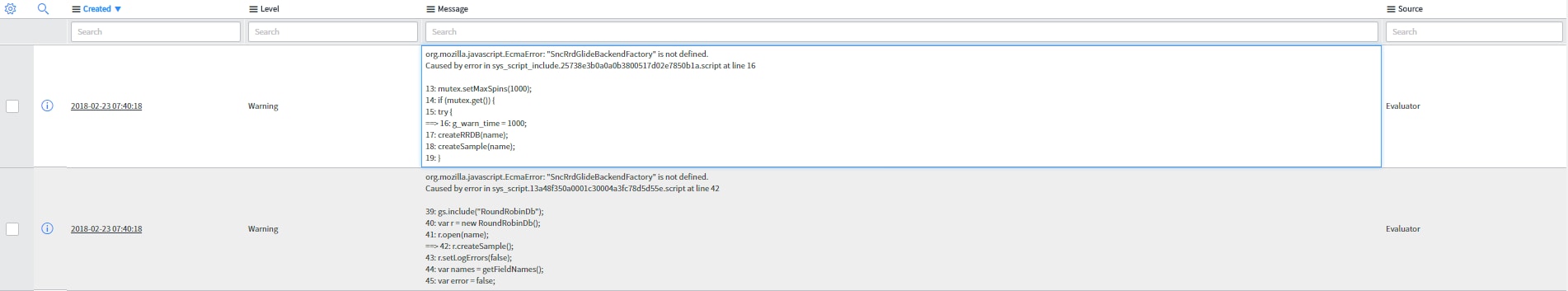

Snapshot from the system logs:
This repeats it self over and over again, not allowing the upgrade to move forward. Can anyone explain what JRobin database is in a ServiceNow context? And has anyone any pointers to what can be done to avoid the errors above? As of now, the nodes are stuck trying to upgrade and spitting out these errors all the time. We have also created a ticket at HI, but we are waiting for a technical resource to be available.
