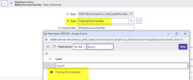

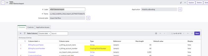

I am trying to import handheld devices and the IMEI#, Billing Reference, and Serial Number are showing 10000000000. I tried to change the Type from Floating Point Number to String but there is no option.
How do I correct this?

Hi @JLeong
You can only change a dictionary entry's data type when the change does not result in data loss. Let's have a look in the below docs to understand restrictions.
Dictionary entry data types
new GlideFieldTypeReference(current).getQualifier();
As Maik's comments, It is highly recommended to avoid changing the type of a column. Experience has shown that a better approach is to create a new column with the new data type and copy the data from the old column to the new column => KB0966730
