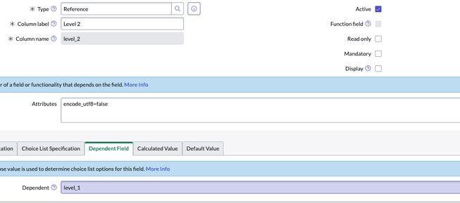

For that I made Level_1 as dependent field of Level_2, and Level_2 as dependent field of Level_3.
The problem is that Level_3 is returning no values.
For Level_2 is working fine.

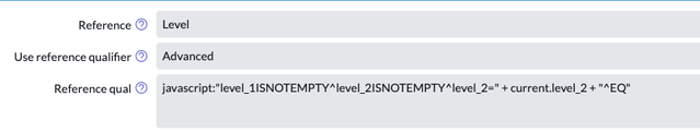

‎12-20-2023 04:28 AM
I could solve this problem using reference qualifier in the reference field.
